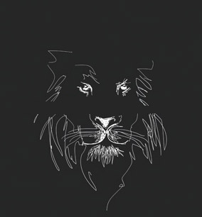

A wacom tablet sketch. Do you think this sort of thing is possible to
inlay? I was thinking maybe work with an extra fine bit for the routing,
and fill it in with some sort of colored dust? How would you approach it?

Black MOP ingrave and fill with white ingraving fillerMichaelP38876.7144328704
PostPosted: Thu Jun 08, 2006 8:34 am
I like the idea of getting a really fine bit (like .005-.010) and routing it
out..very carefully. Like scribing it first, filling with chalk, and then
routing over the top, and then filling it with some inlace (some pearlish or
glittery color..you won't really see the glitter, but it'll give it some sparkle)
The Black MOP is a decent Idea too.

Rectangular silver or gold wire. Look at some of the wire inlay on flintlock rifles from the 1700's.

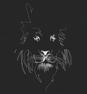

Thanks guys. I'd like to actually do it. It'd be my first inlay. This looks a
bit less like a rabbit and more like a lion.
PostPosted: Thu Jun 08, 2006 11:16 am
Posts: 1051
Inlace will work well...if you feel up to the challenge, silver or gold wire (.005-.010) would be killer. Gold wire (gold plate on brass alloy) would probably stand out more. Neither are expensive.
If you are going to use a machine to do the rout (as opposed to by hand with a graver) then I would consider the mini-grinder (air powered) inlay router that John Hall (Blues Creek, a Sponsor) sells. It is a much higher speed than any kind of router, is easy to control and is very affordable.
The choice comes down to a scratched (graver) surface that then gets fills with a contrasting fill or an inlaid surface (routed) that gets inlaid with wire, inace or other fill.
Either way works and I agree, once you gave the lion a "haircut" he looks much better :)
Good Luck

Print it out at the size you want to inlay it at.
Glue this down to the inlay surface with 3M tack glue. Route using a small bit (I use the stew-mac downcuts) through all of the lines and literally make the pattern you see into the image fully routed. Fill all the areas with thin gold wire (or silver/brass, copper whatever). Make sure your wire is thicker than the route or you'll lose areas below the surface. I would use gold pearl for the more full areas, then build around it. Oh- any kinks in the wire will also be tough to get out so take your time. Wire also raises when heated so sand slowly and carefully All metals heat up a lot when sanding.

I think this will be a lot more difficult than is being made out. Some of the design has a lot of lines crossing and bending back on themselves. Trying to route these out freehand is going to leave a lot of little wood islands. Single lines are hard enough but the overlapping stuff will be very frustrating. Also, forget about the veneer because that will make it even more difficult.
Also, size is a consideration. The area needed for a design this complex is probably much larger than a fingerboard or peghead provides.
I advise picking a simple design with normal inlay methods for your first effort.BarryDaniels38880.5088194444
